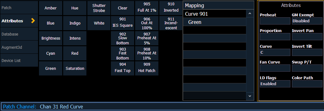

Curves can also be applied to fixtures with non-intensity parameters (NPs). When a channel with NPs is selected in Patch > Attributes > Curve, individual buttons for each available parameter will be displayed in the CIA. Click one or more buttons to apply a curve to the desired parameters.
Eos provides 11 default, commonly used curves. They can be edited or copied to a new curve location. When a default curve is deleted, it will return to its original state.
